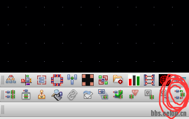

layout界面菜单栏 -> connectivity -> update -> connectivity reference
✔ use schematic view
选择相应的电路
✔ update layout cellviews hierachically
Layout界面:
Connectivity->Option->Connectivity->在General当中勾选Connectivity Reference当中的Schematic XL 就可以在打开Layout的同时自动打开对应的Schematic  如果不想自动打开Schematic  就勾选下面的No Schematic
