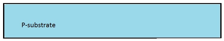

Step1:  P-Substrate is taken as shown in the below figure
P-substrate
P-substrate

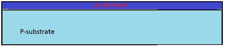

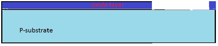

Step2:  The p-substrate is covered with the oxide layer
P-substrate with oxide layer

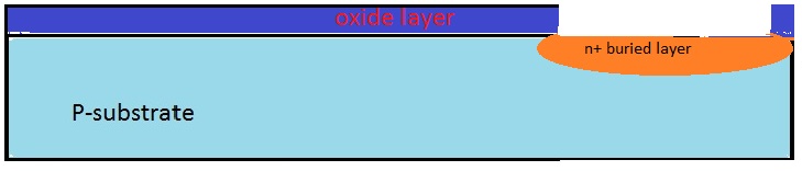

Step4: N-type impurities are heavily doped through the opening

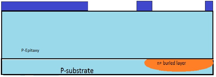

Step6: Again, entire layer is covered with the oxide layer and two openings are made through this oxide layer.
two openings are made through the oxide layer

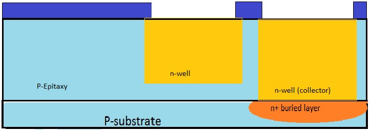

Step7: From the openings made through oxide layer n-type impurities are diffused to form. n-wells

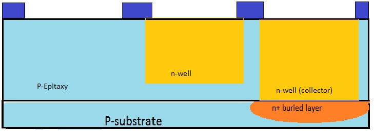

Step8: Three openings are made through the oxide layer to form. three active devices.

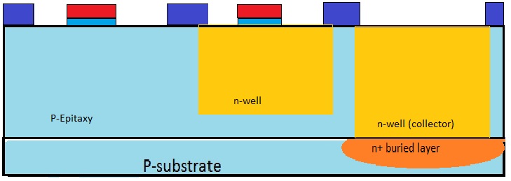

Step9: The gate terminals of NMOS and PMOS are formed by covering and patterning the entire surface with Thinox and Polysilicon.
The gate terminals of NMOS and PMOS are formed with Thinox and Polysilicon

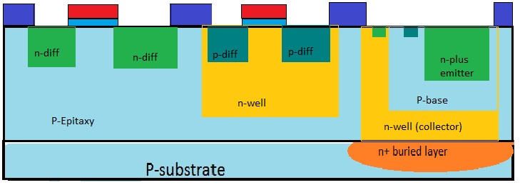

Step10: The P-impurities are added to form. the base terminal of BJT and similar, N-type impurities are heavily doped to form. emitter terminal of BJT, source and drain of NMOS and for contact purpose N-type impurities are doped into the N-well collector.

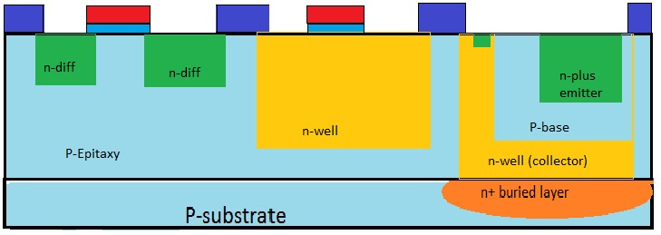

Step11: To form. source and drain regions of PMOS and to make contact in P-base region the P-type impurities are heavily doped.
P-type impurities are heavily doped to form. source and drain regions of PMOS

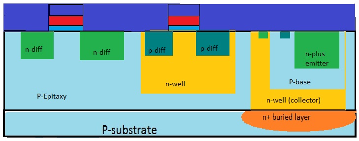

Step12: Then the entire surface is covered with the thick oxide layer.
Entire surface is covered with the thick oxide layer

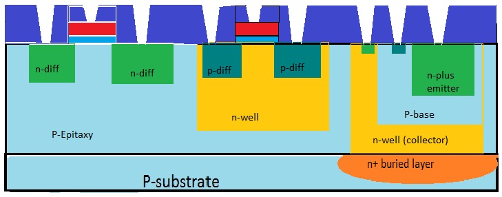

Step13: Through the thick oxide layer the cuts are patterned to form. the metal contacts.
The cuts are patterned to form. the metal contacts

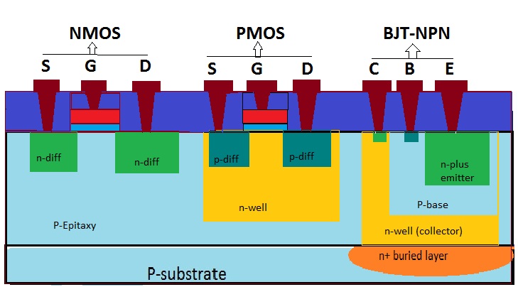

Step14: The metal contacts are made through the cuts made on oxide layer and the terminals are named as shown in the below figure.
Metal contacts are made through the cuts and terminals are named
The fabrication of BICMOS is shown in the above figure with a combination of NMOS, PMOS and BJT. In the fabrication process some layers are used such as channel stop implant, thick layer oxidation and guard rings.
The fabrication will be theoretically difficult for including both the technologies CMOS and bipolar. Parasitical bipolar transistors are produced inadvertently is a problem of fabrication while processing p-well and n-well CMOS. For the fabrication of BiCMOS many additional steps added for fine tuning of bipolar and CMOS components. Hence, the cost of total fabrication increases.
Channel stopper is implanted in semiconductor devices as shown in the above figureby using implantation or diffusion or other methods in order to limit the spreading of channel area or to avoid the formation of parasitic channels.
The high impedance nodes if any, may cause the surface leakage currents and to avoid the flow of current in places where the current flow is restricted these guard rings are used.
