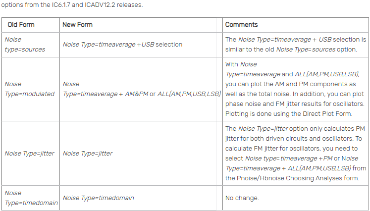

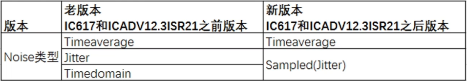

pnoise中Noise Type版本变化
最早:sources/modulated/jitter/timedomain
 IC6.1.7 and ICADV12.2后:timeaverage/jitter/timedomain
ICADV12.3ISR21后:timeaverage/sampled(jitter)
