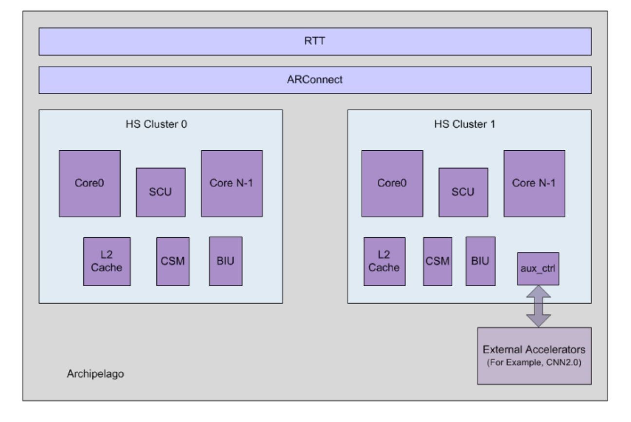

Multi-Core ARC HS ClusterARC HS 是一个基于簇的多核处理器。每个簇可以配置成1-4个核。可以有多个簇(cluster)。如下图所示:
Fig 1 ARC HS36

ARConnect:系统组件集合,提供高效的核间通信,中断分发,debug协助等功能。
下面是ARConnect 组件:
Inter-Core Interrupt Unit (ICI)
Inter-Core Semaphore Unit (ICS)
Inter-Core Message Unit (ICM)
Inter-Core Debug Unit (ICD)
Global Free-Running Counter (GFRC)
ARConnect Power Domain Management Unit (ARConnect -PDM)
Power Management Unit (PMU)
Interrupt Distribution Unit (IDU)
ARConnect Slave Interface Unit (ASI)
